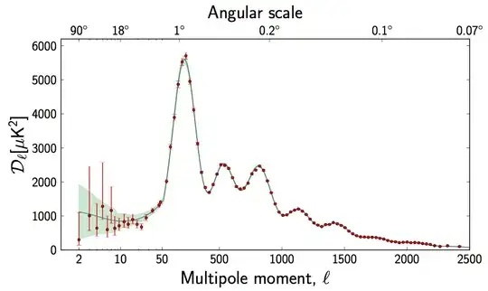

How do we actually determine that the universe is globally flat, you may ask? We use what's known as a standard ruler. Much like a standard candle, if we think we understand the physics, any deviation from what we would predict gives us new information about the universe (in the case of supernovae, it's that they can be used to measure distances, and therefore map out the expansion of the universe). We use the angular size of fluctuations in the Cosmic Microwave Background Radiation (we think we understand the physics behind the fluctuations fairly well) to test how much, if at all, the universe deviates from flatness. The latest results from Planck show very good agreement with the standard picture provided to us by the standard LCDM cosmological model.
Below is the power spectrum of the temperature fluctuations of the CMB. The location of the first peak is what cosmologists use to measure flatness.
CMBPS
