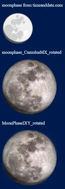

Finally I found such solutions. What I was trying to achieve was to create a Moon Phase image as seen from my location/sky at the current time. I've researched from a lot of places and finally get 3 ways to achieve it. There are pros and cons to each approach. You can see my detailed blog at: Moon Phase orientation as seen from my sky location
the getMoonData.js script in the blog also gives you the current Moon altitude (height)
Belows are the output images from each approach and some application I utilize such images.
output images for 3 approaches enter image description here
