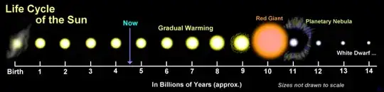

The image below depicts the current ideas of the expected lifecycle and timeline of the life of the sun:
Solar lifecycle

How do we know what will happen to the sun?
Currently, the main method to determine the solar lifecycle is described by the article "The Future of the Sun" (Cowing, 2013) is to:
Studying stars with the same mass and composition as the Sun, the so-called "solar twins," can give us more information about our own Sun; solar twins of various ages offer snapshots of the Sun's evolution at different phases
Where the mass and chemical composition of a star provide the information needed to determine its lifecycle.
