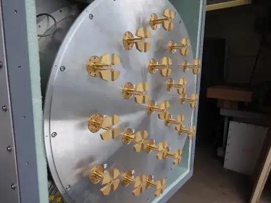

See: "New Technology Offers to Broaden Vision for Radio Astronomy". Even a tiny antenna is very capable, this tiny antenna can see in seven directions simultaneously:
19 Element Phased Array Feed [Click image to zoom]
