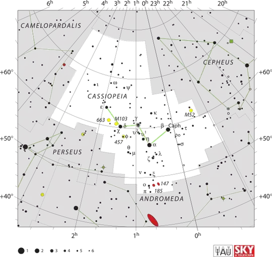

In northern hemisphere, when looking at Cassiopeia (sometimes referred to as the "W"), it’s rightmost brightest star "Caph" (Beta Cassiopeiae) is almost at 0hr RA.

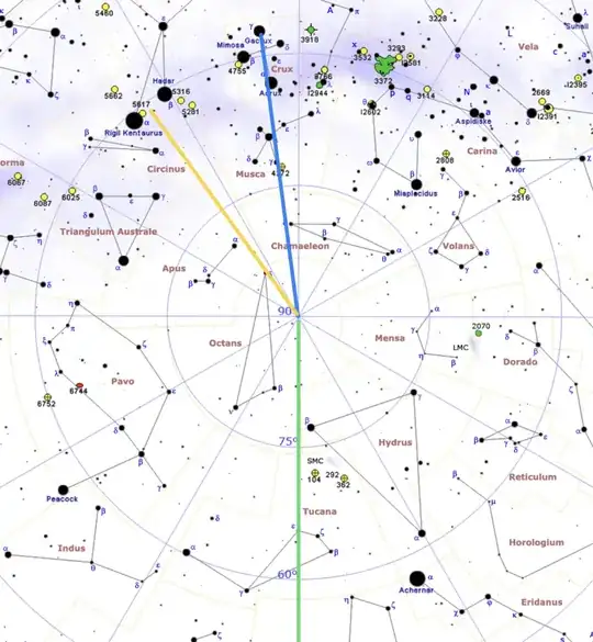

In the Southern Hemisphere, the Southern Cross (Crux) lies at approximately 12.5h RA. You can use the pointer stars (yellow) to locate the south celestial pole, and then continue the line from Crux (blue), perhaps bending it clockwise a little, as a rough guide to the location of 0h RA (green).
