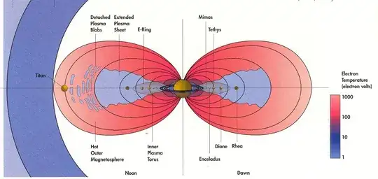

Solar wind (a flux of charged particles emitted by the star) is the main cause for celestial body losing its atmosphere. So, to keep an atmosphere celestial body would need a magnetosphere, that it, a magnetic field which deflects protons and electrons of solar wind and prevents them from giving molecules an energy to escape from upper layers of atmosphere.
According to current studies, the source of planetary magnetic field are eddy currents in liquid metal of rotating outer core, caused by convection and Coriolis force, so called "geomagnetic dynamo".
Now, Luna is pretty much geologically dead now. For the case of Mars, it has been hypothesized what its "dynamo" stopped by some reason, in any case it is a fact what Mars has weak and irregular magnetic field. But in case of Titan (which doesn't even have much metal in core), a gas giant with powerful magnetic field comes to rescue and protects its atmospheres from adverse effect of solar wind.
https://upload.wikimedia.org/wikipedia/commons/5/54/Plasma_magnet_saturn.jpg
As an interesting trivia note, it has been hypothesized what this neighboring with radiation belt is the cause of higher hydrocarbons abundance on Titan.

    What about Venus? It has no magnetic field and is much more exposed to solar wind than other atmospheric worlds. (I'm sorry to ask about Venus, since the answers about it generally seem to be: "We don't know") – LocalFluff Dec 24 '14 at 05:49
  • @LocalFluff, you got me on that! Seriously, it's a really good question and I'd really like to know the answer for (and I wish there would be more Venus studies instead of daydreaming about Mars). Care to post that as question? – Free Consulting Dec 24 '14 at 07:24
  • It isn't useful to ask questions about it, since there are no answers. Venus is kind of a planet non grata, maybe because it is most like Earth. It is an outlier in most theories. IAU should've defined Venus, not Pluto, to be not a planet. If you like to learn about what is not known about Venus, I recommend Dave Stevenson, here's non-informative lecture of his: https://www.youtube.com/watch?v=ORUkiyoYy0E – LocalFluff Dec 24 '14 at 07:39
    Again, no mention of the basics of escape velocities and temperatures, which contribute to the answer. – ProfRob Nov 26 '20 at 18:58
    This also doesn’t explain why the Galilean moons of Jupiter lack atmospheres, despite sitting inside Jupiter’s very strong magnetic field. – Peter Erwin Apr 09 '21 at 15:44
  • That is partially because Jupiter’s magnetic field actually makes it worse, because it traps solar radiation and every moon but Callisto is in the radiation belts, and partly because of the higher temperatures there – A. N Asker Oct 25 '22 at 09:38
  • For reference, a question on why Venus still has its atmosphere exists here; https://astronomy.stackexchange.com/q/10189/18324 – JanKanis Mar 12 '24 at 13:04
