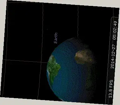

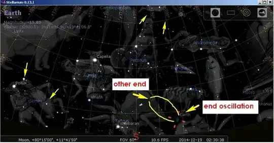

Still new at stellarium but here are some quick capture gif lasting one month. Sorry about the quality- limited to 256 colors for smaller gifs. Date on lower left corner. By the way the sun is of course the brightest and i use it as reference for recording (start record when sun is in frame then stop when it appears again in the same position which is roughly one month)
Location on Moon : Sea of Tranquility
You are looking straight up
Yellow lines are azimuth
second picture:
Zoomed view of earth
One whole day 24 hours (give or take a few minutes)
Location on Moon: Sea of Tranquility
Yellow lines are azimuth (gif itself rotated to approximately match the orientation of the 260 degree azimuth line in the first picture)
Answer for Emilio Pisanty comment on whether the oscillation is detectable by eye
stellarium
Field of view 60 degrees (default view when stellarium first opened)

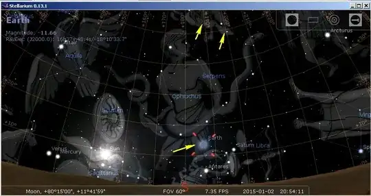

Picture 3
Shows one end of the oscillation near the 200 azimuth line (see yellow arrows)
other end of ellipse near 185 azimuth line
you can use Gemini (lower right corner) for reference (see yellow arrows) from head to crotch of one Gemini twin would be a good reference for how wide the oscillation is (not sure if your sundial can detect the difference)
picture 4
shows other end of the oscilation near the 185 azimuth line (see yellow arrows)

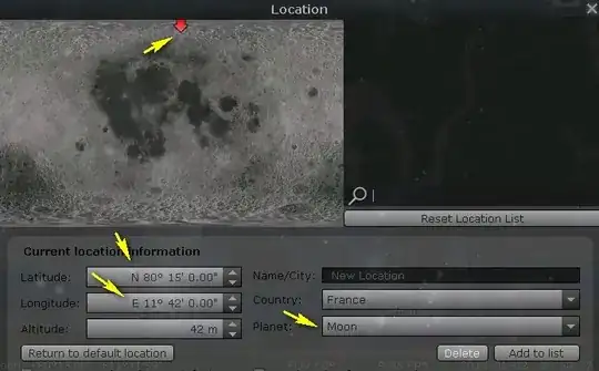

picture 5 shows my stellarium location settings on the moon

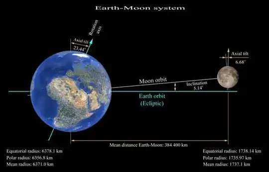

To expand a little more, yes the Earth would hang in the same spot in the sky, moving around in a small circle as the moon rotated around it over the course of each of its 28 day orbits. It would have phases, full Earth when the moon is between it and the sun, new Earth when the Earth is between the moon and the sun, and wax and wane between these two points. Each time the Earth was full, a different part of it would be visible from the moon, depending on the season and how it happened to line up when full Earth occurred.
The Earth would roll in the sky according to the seasons on Earth and the precession of the moon's orbit. The moon tilts only 1.5 degrees from the ecliptic and so in essence has no seasons. The orbit of the moon is tilted 5 degrees from the ecliptic, so when it is farthest to the south of the plane of the solar system, more of the south of our planet is visible, and vice-versa when it is farthest north. But the Earth is tilted 23 degrees from the ecliptic, so this is what would mostly determine what part of it was visible from the moon. Here is a good summary of the relationship of the Earth and Moon. The distance between the two bodies is not to scale, but the relative size of the one to the other is to scale.
the orbit of the moon around the Earth
