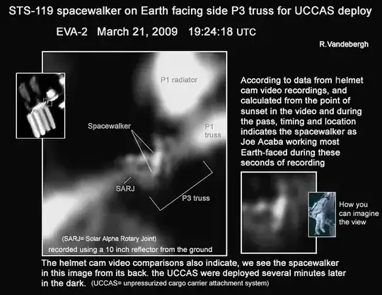

This has been done before, so I don't have to go through all the heavy calculations using Rayleigh criterion accounting for atmospheric diffraction and visible light wavelength. Ralf Vandebergh, a Dutch astronomer, professional photographer and veteran satellite spotter has been busy trying to do exactly this since the 2007 and has indeed succeeded on several occasions by now using a 10 inch (25.4 cm) Newtonian reflecting telescope that has a resolving power (angular resolution on the CCD sensor) of roughly one pixel per meter at the distance to the International Space Station (ISS) that is currently in a 230 miles (370 km) orbit above the Earth:
   Ralf Vandebergh’s detail of an image he took on March 21, 2009 showing astronauts working outside the ISS. Credit: Ralf Vandebergh
   Ralf Vandebergh’s detail of an image he took on Mar. 21, 2009 showing astronauts working outside the ISS. Credit: R. Vandebergh

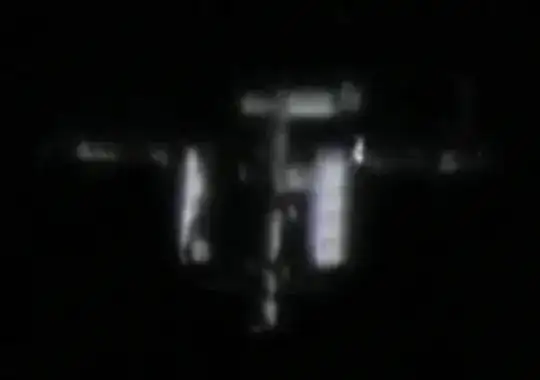

Vandebergh's personal page also hosts all kinds of other successful observations of the ISS through his telescope and recorded in both photographs as well as some short videos. Why short? Because targeting the ISS as it moves at the speed of 4.8 mi/s (7.7 km/s) is rather tricky, and the atmospheric conditions and times at which the ISS passes over some area on the surface of the Earth don't make it any easier either. But perseverance and hard work have paid well for this individual astronomer.
          Raw video of the ISS as seen through the air turbulence. Note the good visibility of the Lira antenna at the Russian
          Zvezda Module in the lower part of the image. Credit: R. Vandebergh
So again, skipping the math to calculate the required angular resolution of a telescope and apply that to some arbitrarily selected image sensor size and resolution, we can see that using a well collimated 10 inch Newtonian or a Dobsonian telescope on a clear night can, with some near perfect targeting, produce a direct proof of a spacewalker doing his or her job 230 miles (370 km) high during an EVA. More powerful telescopes would of course produce better resolution images, but the atmospheric effects limit their use and are of course much harder to target an object moving fast over the skies with.

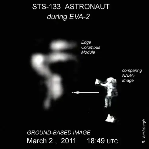

Ralf Vandebergh is one of the best amateur astronomy photographers out there who does spacecraft photography. He is using a 10" (25.4cm) Newtonian telescope, as far as I know, so this is pretty much an off the shelf telescope.
He supposedly has imaged spacewalkers on previous ISS and STS missions. Though they are only a few pixels in size, and you cannot make out any details. Nevertheless, his images are definitely, absolutely stunning:
STS-133 Astronaut during EVA-2 (by Ralf Vandebergh)
