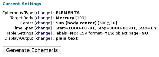

I might be misunderstanding your question, but using HORIZONS (http://ssd.jpl.nasa.gov/horizons.cgi) with these settings should give you the data you need:
