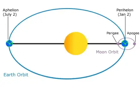

However, the orbits of the Earth around the sun and the moon around the Earth are elliptical, as illustrated in the diagram below:
Image source: NOAA
This results in the exact ratio mentioned above not occurring resulting in an annular eclipse, where the moon is too 'small' to fully cover the solar disc.
