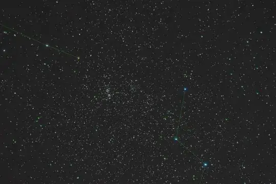

I second nova.astrometry.net. For basic identification of constellations and brighter stars it's excellent and simple to use. Here's one of my images that includes part of Casseiopeia, identified by the website.
(source: https://flic.kr/p/2kKM4vA)
On the other hand, it has the drawback that the labeling is rather sparse. If you're looking to determine the faintest magnitude your DSLR can pick up with various lenses, that turns out to be more difficult. I try to do this by comparing my photos with astronomy apps like Sky Safari and Stellarium, but that approach likewise has its drawbacks.
