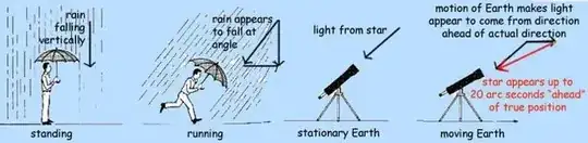

Aberration per se is easy to explain via the old analogy to running through the rain. When you're standing, rain falls vertically. When you're running, rain appears to come from a different direction. Same with starlight. Like in this diagram (by Professor Courtney Seligman, linked above):
