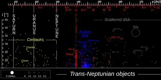

Why is not always easy to answer, especially not for a specific object. We may seek a population-based answer, by having a look what population Eris is a part of, and hopefully having some simulations that let us understand where this population came from.
If we look at the inclination distributions of objects in the outer solar system, we see the following populations, and see that Eris is part of the 'scattered disc' population:
inclinations of TNOSs
