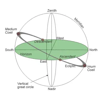

The Ascendant-Descendant axis is the line of intersection of the ecliptic plane with the rational horizon. The ecliptic is the plane of the Earth's orbit. The rational horizon is the plane through the geocentre (the Earth's centre) which is parallel to the observer's local horizon. So the Ascendant-Descendant axis passes through the geocentre. The Ascendant is to the east, the Descendant is to the west. Hence the Ascendant is the point on the ecliptic that is currently rising.
Here's a diagram from an article on the Astrodienst site, Astronomical Foundations of the Astrological Houses, by Christopher A. Weidner.
Rational horizon, ecliptic, ascendant
We can easily calculate the Ascendant using spherical trigonometry. Wikipedia gives the equation, but it's in a slightly misleading format. Here's a better version:
$$\lambda_{\rm Asc} = \arctan \left(\frac{\cos\theta_{\rm L}}{-(\sin\theta_{\rm L} \cos\varepsilon + \tan\phi \sin\varepsilon)} \right)$$
where $\theta_{\rm L}$ is the local sidereal time, expressed as an angle, $\varepsilon$ is the obliquity of the ecliptic, and $\phi$ is the latitude of the observer (north positive, south negative).
