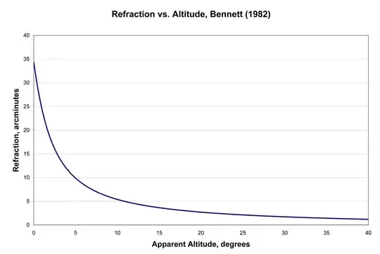

The 33'25" is, coincidentally, roughly equal to the diameter of the full Moon, meaning that, when α Cen culminates, it is a Moon diameter below the horizon. It is, also coincidentally, roughly equal to the angle of atmospheric refraction toward the horizon, as seen in this parametrization:

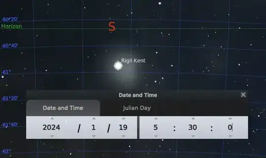

That means that α Cen should juuust graze the horizon. According to Stellarium, tonight it will happen at 5:30 in the morning:
stellarium Position of α Cen — here called "Rigel Kent" — at culmination on 19 January 2024, as seen from Eilat. It will reach roughly 30' below the horizon, but refraction should take it roughly 30' closer to the horizon. Created using the free software Stellarium.

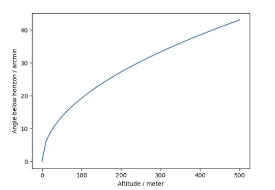

Using standard trigonometry, you will find that the distance $d$ to the horizon seen from an altitude $h$ is $d = \sqrt{2hR}$, where $R$ is the radius of the Earth. The angle $\theta$ below the horizon that you can see is given by $\tan\theta = d/R$. I've plotted this relation below, from which you can see that you need to increase your height to 200–300 meters (not taking into account refraction).
dip vs. h
Google tells me you don't have many tall buildings in Eilat, but the nearby Mt. Shahmon may help you, if you can get a clear view toward the horizon.
