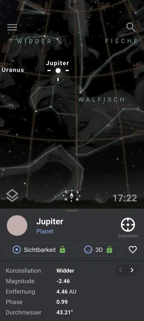

When I was walking in the evening (2023-12-30) in the south of Germany (roughly 49°N 12°E) I noticed a single bright object in the sky, and (not being an astronomer) I wondered what it might be. So I started Stellarium to point at the location to find out that it's Jupiter (you'll see the photo and the screenshot below).
Part of the sky shot with my smartphone without tripod Screenshot of Stellarium showing the same part of the sky, including details of Jupiter
What made me wonder is the "phase 0.99": Does it mean sun, earth and Jupiter are mostly in one line, so Jupiter will reflect as much light as possible back to the earth?
Wikipedia says Jupiter is about four times as far from sun than earth is, and it has about 11 times the size. I wonder: What would be the brightest star in comparison, and how bright would it be (as a proportion)?

    Guten Abend! Yes, Jupiter is almost in straight line with the Earth and the Sun—the “perfect“ line was on November 3, 2023; it’s also called the “opposition.” Jupiter is brightest around opposition, but it’s generally a very bright “star” in the sky, so you probably just didn’t notice it before. – Pierre Paquette Dec 30 '23 at 21:57
    Minor not, regarding roughly 45°N 12°E -- that's central Italy, not southern Germany. Did you perhaps mean "roughly 48°N 12°E"? That is fairly close to Munich. – David Hammen Dec 31 '23 at 13:04
    That happens if you think you remember the numbers correctly; actually it should have been 49°N, sorry. – U. Windl Jan 01 '24 at 19:45
  • @PierrePaquette does this mean (in layman's terms) it was "full Jupiter"? - i.e. sun lit up most/all of Jupiter as it's viewed from earth? If I understood correctly, you should make it an answer as that's probably the simplest explanation? – stevec Jan 02 '24 at 01:06
    @stevec The moon has strong phases (as seen from Earth) because Earth is sometimes looking at the night side (the one that faces away from the Sun, towards the outer solar system), and sometimes looking at the bright side (the Sun-facing one). This changes rapidly due to the Moon's orbit around Earth. But no matter where Earth is in its orbit relative to the "Jupiter side" of the solar system we're always looking fairly close to directly at its bright side; it's always close to "full Jupiter". We'd have to get out near or beyond Jupiter's orbit to see much of its night side. – Ben Jan 02 '24 at 02:13

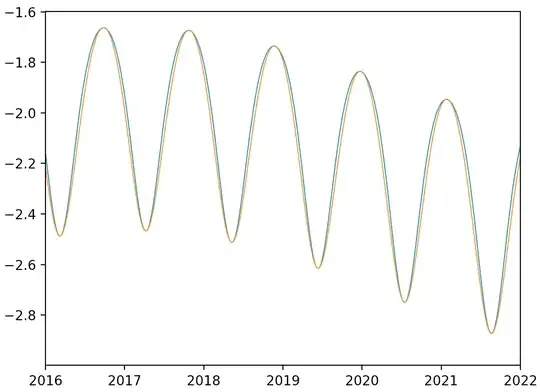

tl;dr: There's about a 1.4 mag oscillation due to $1/r^2$ effects and only a very tiny residual due to illumination angle.

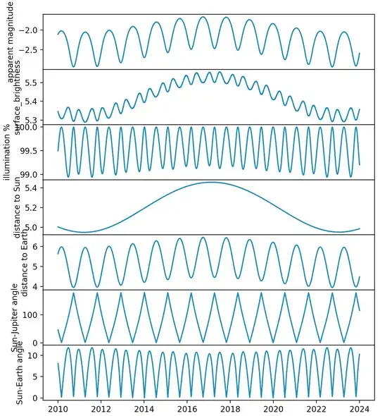

I went to JPL's Horizons and extracted the distances between Jupiter and the Sun and the Earth, as well as various angles, illumination fraction, and the apparent magnitude of Jupiter as seen from the Sun.
It's pretty clear that the primary variation in brightness is due to $1/r^2$ and there's only a tiny effect related to illumination changes. While illumination fraction is only part of that effect, it's notable that it never drops below 99%.
In the first plot I show calculated apparent magnitude from Horizons' detailed modeling, and a simple expression based on only
$$-2.5 \log_{10}\left(\frac{1}{r_{Sun-Jupiter}^2 \ r_{Earth-Jupiter}^2}\right) + C.$$
The value of $C$ is chosen to make the maximum equal to the Horizons maximum, and we see that the minima line up as well.
Of course at max and min the illumination fraction is 100% and the Sun-Jupiter-Earth angle is essentially zero.
The slight deviations at the half-way points are when this angle is maximum and the illumination fraction minimum (but still 99%).
JPL Horizons Jupiter apparent magnitude from Earth vs simple model
JPL Horizons Jupiter apparent magnitude from Earth and other things

    Can I read from the last graph that "apparent magnitude" and "surface brightness" increase when the "distance to Sun" (and "distance to Earth") increases (I'd expect the opposite to be true), or is it just accidental? – U. Windl Dec 30 '23 at 23:30
    @U.Windl magnitudes are calculated using a negative sign in front of the logarithm (as shown in my expression). When the apparent magnitude, and the surface brightness (apparent magnitude per arcsecond squared) values increase, it means they get dimmer, not brighter. – uhoh Dec 30 '23 at 23:33

Jupiter appears particularly bright because it is close to Earth at the moment, it is also high in the sky (in the Northern Hemisphere). However its brightness doesn't vary that much.
Jupiter reached opposition in November (when it was directly opposite the sun) and the Earth has now (two months later) moved so that the angle between the sun and Jupiter is 116 degrees (value from Wolfram Alpha). From our perspective (near to the sun) Jupiter is always close to 100% phase angle, we don't notice "phases" of Jupiter in the way that we notice them on the moon or Venus.
Jupiter is always very bright. At its brightest, it is nearly Magnitude -3, which is much brighter than any star. Moreover, when Jupiter's opposition occurs during the winter, it will be very high in the sky at midnight, and so appears impressively bright. Jupiter is always brighter than magnitude -1.5, and so always a bright object, but when it is close to the sun or close to the horizon it can appear less impressive.

  • uhoh's answer seems to say that Jupiter appears (much) brighter when it is close to the Sun, in fact that this is the dominating factor. You seem to contradict that. Can you resolve the contradiction? – Peter - Reinstate Monica Dec 31 '23 at 14:58
    @Peter-ReinstateMonica There's no contradiction. uhoh's answer says only that the brightness change is caused by "1/r^2 effects", but if you look at their graphs, you can see that the change in Jupiter-to-Earth distance is much larger than the change in Sun-to-Jupiter distance. So Jupiter's position in its orbit doesn't make that much difference to its brightness. – David Dec 31 '23 at 15:10
    Uhoh's answer is correct and detailed, the variation is mostly due to the Earth Jupiter distance, and secondarily due to Jupiter sun distance and phase. Jupiter is brighter than average because the Earth is close to Jupiter. It appears especially bright in Germany because it is high in the sky. It also happens to be quite close to the sun, and be at nearly 100% phase. – James K Dec 31 '23 at 15:17
