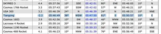

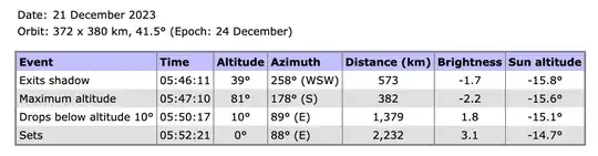

Your question was posted December 21 evening (ET). Heavens Above (using @ProfRob's link to Heavens Above for location (lat=41.9789, lon=-72.5755) and time zone (tz=EST)) and selecting Morning for December 21, the Taingong space station at -2.7 mag was crossing west to east between 5:46 and 5:51 with a near-zenith maximum elevation of 81°.
