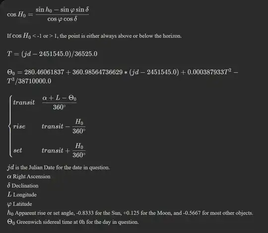

    Since you have the Meeus book, use the Rise, Set, Transit algorithm, but set $ h_0 $ to the alt you want. – Greg Miller Oct 21 '23 at 04:34

    @GregMiller - I don't have the book. I've just done a lot of Internet searches on the subject and thought I had the right equations based on what I've read. I was hoping someone could point out what I have wrong. – BillR Oct 21 '23 at 16:48
    The equations are here: https://celestialprogramming.com/risesetalgorithm.html – Greg Miller Oct 21 '23 at 18:52
  • @GregMiller - Thanks for that reference. I decided to try something simple and just compute the meridian transit using those equations but am still not getting the right answer. One problem I encountered is that the web site appears to assume west longitude as a positive value, is that correct? Because if I enter a negative value for my west longitude, the result isn't anywhere near close to being correct. But if I enter it as a positive value, the calculator yield precisely the correct answer. But when I use the equations to compute the transit time, the result is ~30 minutes off. – BillR Oct 22 '23 at 16:44
  • Using the values in the OP: JD0 = 2460235 T = (JD0 - 2451545) / 36525 = 0.237932922655715 Theta0 = 3137426.22907707 % 360 = 26.2290770742111 Transit(deg) = 359.648 = 23.976 hours = ~23:58:34 But the correct transit time is 00:37:08, about 40 minutes later. I can't figure out what I'm doing wrong. – BillR Oct 22 '23 at 16:53
    @GregMiller - I think I found the problem. There appears to be an error with one of the formulas on that website you referenced. It shows transit = (Dec + Long - GMST)/360, but in your C source code, you have transit - (RA + Long - GMST)/360. When I use RA instead of Dec in that equation, I get the right answer. – BillR Oct 26 '23 at 15:24
