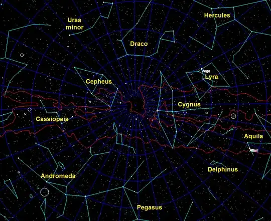

The orientation of Mars's axis is such that its north celestial pole is in Cygnus at R.A. 21h 10m 42s Decl. +52° 53.0′ (or more precisely, 317.67669 +52.88378)
The top two stars in the Northern Cross, Sadr and Deneb, point to the north celestial pole of Mars. The pole is about halfway between Deneb and Alpha Cephei, less than 10° from the former, a bit more than the apparent distance between Sadr and Deneb.
Because of its proximity to the pole, Deneb never sets in nearly all of Mars's northern hemisphere. Except in areas close to the equator, Deneb permanently circles the North pole. The orientation of Deneb and Sadr would make a useful clock hand for telling sidereal time.
Here's a view of the celestial north pole on Mars.

So we can take the angle between Earth's axis and Mars' axis as the complement of declination of North Celestial Pole of Mars, right? – Aarush Mishra Aug 11 '23 at 19:30
