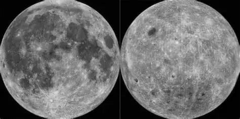

As is well known, and as you can see in the image below, the far side of the Moon is brighter than its near side. What is its overall albedo? And what would be the magnitude of a full moon if the (current) far side were facing us? sides of moon

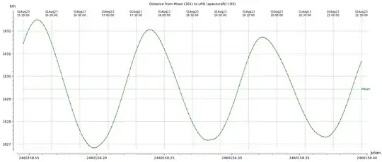

The LRO has a sidereal period of almost 2 hours (1h 57m 2.9s). Here's a plot showing its distance from the centre of the Moon, covering 6 hours, with a 2 minute timestep.
LRO-Moon distance I made that plot using the script here. I have a magnitude plotting script here.

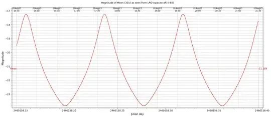

Here's a Moon magnitude plot covering the same timespan (using the same timestep).
Moon magnitude, Full

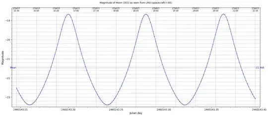

And here is the corresponding plot for the previous new moon (2023-Jul-17 18:32:50 UTC).
Moon magnitude, New
The mean magnitude on the new moon is -21.466, which is slightly brighter than the full moon mean of -21.168. Interestingly, the peak magnitude at full moon is slightly higher than at new moon. The minima during the new moon are noticeably brighter that at full moon. I assume that's mostly due to earthshine.
However, Horizons doesn't say how it computes these magnitudes, and it gives this warning:
Moon's approximate apparent visual magnitude and surface brightness. When phase angle < 7 deg (within ~1 day of full Moon), computed magnitude tends to be about 0.12 too small.
