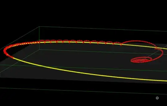

Here's a view looking from above (north) of the ecliptic plane, from 2023-Jul-15 0:00 UTC, using a 1 hour time step. Earth is blue, the Moon is yellow, the spacecraft is red. The grey line is the X axis, which points towards the First Point of Aries (the equinox point). The plotted points are connected with cubic Bézier curves, using the normalised velocity vectors to compute Bézier control points.
Earth, Moon, Chandrayaan-3
This trajectory has a significant component in the north-south axis:
Side-on view showing N-S component
These are screenshots from this interactive 3D plot. There's some info on how to use that plotting script here.
Note that you can set the Moon (ID 301) as the center. I recommend a start time of Aug-10, and you should probably toggle off the curve plotting.
