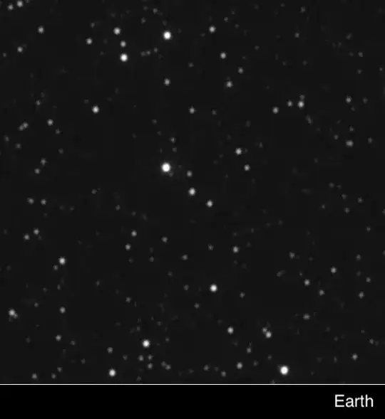

Spacecraft such as Pioneer, Voyager or New Horizons are designed to study planets, and their cameras and telescopes to obtain good images of them, not to perform precision astrometry.
Anyway, as a "technology demonstration project" in 2020 NASA executed "The New Horizons Parallax Program", in which the New Horizons spacecraft photographed 2 stars, Proxima Centauri and Wolf-359.
Observatories and amateur astronomers around the world were asked to record both stars with their cameras at the same time as New Horizons did.
The subsequent superimposition of the image taken by New Horizons on the image taken from Earth would then allow the parallactic displacement of the observed stars to be detected, relative to the background of distant stars.
Again, this was a demonstration project intended to popularise astronomy and astronautics; the New Horizons telescope is not designed to measure parallaxes accurately, so this activity has no scientific value.
But it was demonstrated that it was possible, in the future, to design a spacecraft and place it in orbit far away from the Earth to specifically measure parallaxes by recording the same star from the spacecraft and from the Earth at the same time.
In this image below, the comparison between the image of Proxima Centauri recorded by New Horizons and the one recorded from Las Cumbres Observatory, Siding Spring, (0.4 m telescope), Australia.
Proxima Centauri
And this other image is of Wolf 359 from New Horizons and from the Manner 0.6 Meter Remote/Robotic Telescope at the University of Louisville, Arizona USA.
Wolf 359
