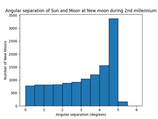

Mean angular separation of about 3.2°, based on skyfield Python library simulation of the 2nd millennium.
This is pretty dependent on your viewing location. The moon's orbit is inclined roughly 5° to the ecliptic and goes through processive and nutation cycles on a timescale a couple decades.
For the purposes of this answer, I assumed the viewpoint from the center of the Earth, and ignored atmospheric refraction.
I used the following skyfield script to look between 1001-01-01 00:00 UTC and 2001-01-01 UTC for New Moons, and calculate the angular separation between the Sun and the Moon from the center of the Earth.

The following results were returned:
12369 New Moons found.
Minimum separation 0.000°
Average separation 3.186°
Maximum Separation 5.011°
With the following histogram:
Angular Separation of Sun and Moon at New Moon during 2nd millennium
As Michael Seifert mentioned in the comments, the moon in general spends more time in its orbit near the upper range of the angular separations, resulting in the spike of separations nearing 5° inclination.
That said, 5° is still fairly close visually, about the visual width of the three center fingers on an extended arm, though with angular radii of about 0.25° each, as David Hammen mentions, probably the first two to four bins would be "skirting the edges" of the solar glare for a human observer.
Venus (maximum elongation 47°) is almost always going to be more angularly distant from the Sun than the New Moon. Lightly modifying the script, I'm finding only 504 of the 12369 New Moons in the 2nd millennium where Venus is angularly closer to the Sun viewed from the center of the Earth, a bit under 4.1% of the total.

    Rather than comparing to Venus, it would be more useful to compare to the Sun. Given that the angular radii of the Sun and Moon are both about a quarter of a degree, the "skirting around the edges somewhere" cases would be your first two to four bins. The remaining bins are not "skirting around the edges somewhere" -- and that's the vast majority of the cases. Nice answer, BTW. – David Hammen May 19 '23 at 11:16
  • This distribution makes a certain amount of sense. When the moon is at its farthest above or below the ecliptic plane, it is not moving very fast towards/away from that plane, and so it spends more time at a high angular separation from the ecliptic plane. Conversely, when the Moon is passing through the ecliptic plane, it is moving relatively fast to that plane and so spends less time at small angular separations from the ecliptic plane. – Michael Seifert May 19 '23 at 14:04
