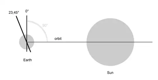

And - last but not least - as for your question how they know where 0 degrees would be, you just have to look at the Earth's rotation around the sun. Take a 90° angle of the planet's orbit and you know where 0° would be. But I guess a picture explains more than a thousand words, so I quickly created the following graphic:
tilt and axis explained
