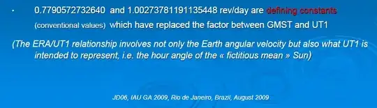

(edited 2023/Mch/27 to add references including text+image extract of IAU 2009 explanation showing continuing relation of UT1 to the sun.)

IAU Gen Assembly 2009 UT1 expln The presentation showed that the sun's mean position (in hour angle) is still intended to be represented by UT1, also in the context of use of the ERA formulae (constants shown above in their post-2006 revised values). The details of this representation have previously been discussed in Astronomy SE, at (Does Universal Time really track mean solar time?).
