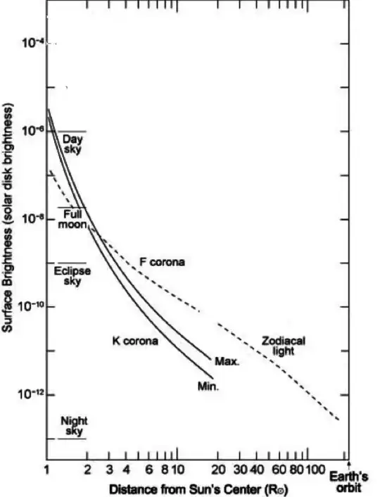

It's an interesting question but a bit difficult to judge as you need a measure for the brightness of the sky as function of angular distance from the Sun - a figure seemingly hard to find as many papers are behind paywall I have no access to.
There is this poster by Jim at al or this ancient article by Abbot et al. Converting the former to magnitudes as used usually in astronomy I get an area brightness of the daytime sky of about -12 magnitudes, the latter gives the sky brightness as about $10^{-10}$ of the solar disk, so rather -16mag. The brightness of the sky also does vary quite a bit according to this study (I don't have access to the original data they quote by Lang 2010). However this indicates nicely also the brightness levels of full moon an eclipse sky and the solar corona:

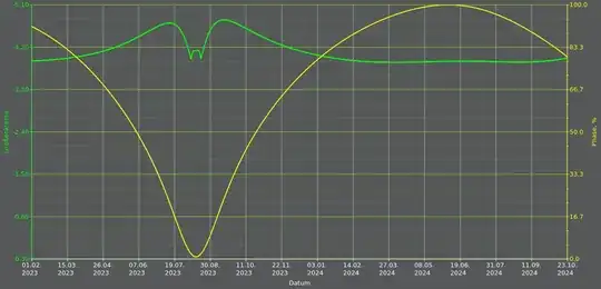

As to the angular distance to the Sun when it is visible: The brightness of Venus does not vary that dramatically: In green is the magnitude of Venus and in yellow the phase of Venus which I plotted here for roughly one cycle with Stellarium.
Thus in summary: going by the from Lang and the brightness of Venus, and given the two observational accounts above and my own observational experience, it seems safe to deduce that one can see Venus at least as close as a few solar disk radii away from the Sun - if you know exactly where to look.
