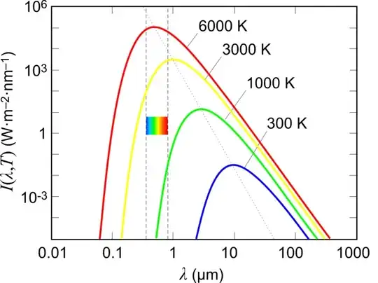

  • By steep I mean that, for 6000 K the peak intensity looks to be at least 10 or 15x greater than the intensity at long wavelengths. For 3000 K, it's maybe only 2x. So if the wavelengths of that 6000 K emission were all stretched, the graph would still show more EM at shorter wavelengths than from an unstretched 3000 K black-body – GulbenkianD Jan 28 '23 at 21:06
    @GulbenkianD at long wavelengths the intensity goes to zero - there's no one value you can point to and say that the maximum is 10x greater. You're comparing apples to oranges. This answer shows that the graph does have the same shape, but squeezed in the vertical direction and stretched in the horizontal one. – Javier Jan 29 '23 at 13:43
    @GulbenkianD Your impression that the shape changes is only an optical illusion when you plot the Planck curve in a linear fashion. If you plot it logarithmically, you can see that a temperature change only results in a upward/downward and sideways displacement of the curve. See https://commons.wikimedia.org/wiki/File:Planck_law_log_log_scale.png . This also follows algebraically from the Planck formula as shown in my answer below. – Thomas Jan 29 '23 at 16:04

From the double-logarithmic plot below you can see that a temperature change (be it real or apparent due to the redshift) does not change the shape of the Planck curve but only displaces it upwards/downwards and sideways. Your impression that the shape changes is only an optical illusion when you plot the curve linearly (as it is usually done).
