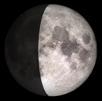

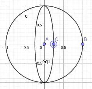

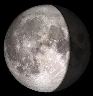

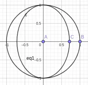

The line is a semi-ellipse. It is formed by projecting the great circle on the moon formed by the terminator to the plane perpendicular to a line going from the observer to the moon. Projecting a circle to a plane results in an ellipse.
These pictures show simulations of a "thin crescent" or "nearly full gibbous" and "near half moon" (depending on which part you consider to be lit).

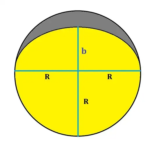

You must draw a semicircle of radius R and a semi-ellipse of semi-major axis "R" and semi-minor axis "b". To calculate "b" knowing the illuminated ratio "n":
$$n=\dfrac{\dfrac{\pi R^2}2+\dfrac{\pi R b}2}{\pi R^2}$$
Simplifying:
$$\boxed{b=(2 n - 1) \ R}$$
If "$n_{pc}$" is expressed in %
$$b=(2 n_{pc} - 100) R$$
With the values of "R" and "b" it is easy to draw the semi-ellipse of the terminator using, for example, rectangular coordinates:
$$\boxed{y=\dfrac b R \sqrt{R^2-x^2}}$$
