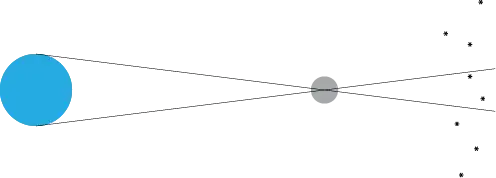

Because when the shadow of the moon hits the earth for eclipse, it's only a small shadow that covers a little zone of the earth and lasts a brief moment.
When the earth shadow passes on the moon, it lasts a lot longer and it's a bigger shadow. They measured the time 2250 years ago and found the earth is 3.5 times bigger than the moon:

The necessary technology is the eyes and the mind. Nothing else.
  1. Solar eclipses show that the shadow of the Moon gets smaller by one Moon-width as it goes from the Moon to the Earth. That is, the width of the shadow when it lands here is either a few hundred miles (total eclipses) or less than zero (annular eclipses).
  2. Therefore the shadow of the earth when it hits the moon in a lunar eclipse is one Earth width minus one Earth width.
  3. The Moon travels its own width each hour. A lunar eclipse lasts up to 90 minutes. So the Moon is totally immersed over a distance of 1½ Moon widths.
  4. So the Earth’s shadow “out there” is 2½ Moon widths wide.
  5. So the Earth’s shadow “down here” is 3½ Moon widths wide.
  6. So the Earth is 3½ times the diameter of the Moon. A

    look at the graphic posted: Your point 2. should end with "one Earth width minus one Moon width" besides this mistake your post is a nice textual animation of that graphic – Bobby J Dec 25 '22 at 09:59
  • The Moon travels its own width each hour. A lunar eclipse lasts up to 90 minutes. So the Moon is totally immersed over a distance of 1½ Moon widths.
    Are you implicitly assuming the earth's shadow doesn't move during a lunar eclipse? (it travels at the speed of the sun, which is much smaller than the speed of the moon, but I think it should be mentioned)
    – JiK Dec 25 '22 at 22:00
  • Also to avoid confusion, I would mention that the speeds you mention are relative to the stars in the sky, not affected by Earth's rotation. – JiK Dec 25 '22 at 22:03
