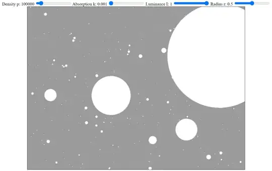

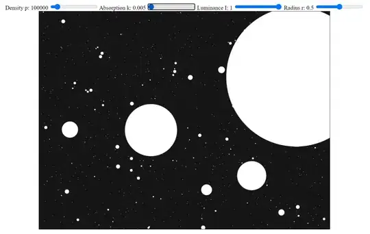

I have written a basic simulation to validate the effects of non-luminous matter quantitatively and qualitatively. Code here. It directly applies the exponential decay law by assuming a uniform random density of stars and a uniform density of non-luminous matter throughout space. The simulation even cheats massively in favor of Olbers's Paradox by modeling the infinite backdrop of stars at varying distances as a purely luminous wall of light at a fixed, finite and even shortest possible distance beyond the foreground model of direct sampling. This means we have a strict theoretical upper bound on the total light emanating from distant stars. The density of non-luminous matter is controllable as a parameter p. The simulation shows that for even very small values of p, a purely luminous wall would be practically invisible, or else be indistinguishable from cosmic microwave background radiation (interstellar attenuation not only decreases apparent intensity, it also induces reddening).
In other words, Olbers's thought experiment would fail to falsify even the hypothetical existence of a contiguous sphere of light as luminous as the surface of the brightest star enveloping the entire visible portion of the universe. It can say nothing about what is beyond the photons that reach us--nor does it tell us anything about the photons that didn't reach us.
If one sets p=0, the entire field of view is indeed saturated by pure, contiguous starlight under this simulation. But for any non-infinitesimal density p of attenuating matter, the visualization -- and the mathematical solution for expected light intensity over all points in space--converges sharply towards a model that perfectly resembles what we see in our night sky, regardless of all other parameter settings.
In the following two images, the absorption value is increased only slightly, starting as close as the simulation allows to zero at first: Very low absorption parameter
Low absorption parameter
In both images, there is a perfectly bright wall of simulated stars a short, fixed distance away from the observer. Radiation from that wall leaks and is visible as a uniform grey background when the simulated wall is very close and the density of attenuating matter approaches zero, but if the wall of light is slightly more distant or the density of attenuating matter is only slightly increased, the background approaches pitch black, despite there still being an infinite number of perfectly bright stars intersecting every possible line of sight.
You can bump up the stellar density, radii and luminosity as high as you want, and even a tiny percentage of non-luminous matter still overwhelms the resultant apparent brightness calculations with the exponential decay induced by material attenuation.
