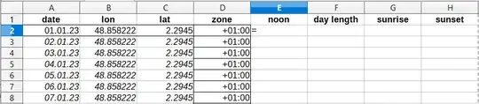

What I want is to make a spread sheet with one row per day, where column
A = the date (here, input as spreadsheet date)
B = lon (W is negative, E is positive)
C = lat (S is negative, N is positive)
D = time zone (here, input as spreadsheet time)
What I needed is two formulas,
E = true noon
F = day length
so that I can get sunrise and sunset as
G = E - (F/2)
H = E + (F/2)
I think in the spreadsheet I once had, it took two sine calculations and some constants to get this done.
Example spreadsheet
Please help me get this working again or to find the sources where it is explained.

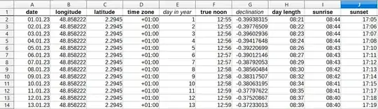

I finally found the source, or at least something like the source I had once back then. So I got this to work again:
Sunrise—sunset table
These are the formulas needed:
E2 =DAYS(A2;DATE(YEAR(A2);1;0))
F2 =(12+0.1752*SIN(0.03343*E2+0.5474)+0.134*SIN(0.0182334*E2-0.1939)-C2/15+24*D2)/24
G2 =0.40954*SIN(0.0172*(E2-79.35))
H2 =ACOS((-0.0145-SIN(B2*PI()/180)*SIN(G2))/(COS(B2*PI()/180)*COS(G2)))/PI()
I2 =F2-H2/2
J2 =F2+H2/2
As per the source I took it from, this is imprecise ±5 minutes.
