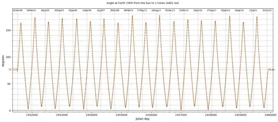

Perhaps a better indicator of alignment is the angle from the Sun through the Earth to Ceres. From the Horizons manual:
23. Sun-Observer-Target (apparent solar elongation) angle
Sun-Observer-Target apparent SOLAR ELONGATION ANGLE seen from the observers' location at print-time.
The S-O-T solar elongation angle is numerically the minimum separation angle of the Sun and target in the sky in any direction. It does NOT indicate the amount of separation in the leading or trailing directions, which would be defined along the equator of a spherical coordinate system.

Here's a plot of the Sun-Earth-Ceres angle for 23 years, with a time step of 5 days. 23 years is slightly under 5 times the orbital period of Ceres (1683.2583 days), and slightly more than 18 times its synodic period.
S-O-T plot
As you can see, the maximum angle only rarely reaches 170° near opposition.
