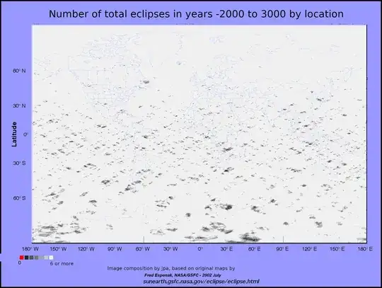

Here is a combination of the maps available from NASA SEAtlas. They cover time span from year 2001 to 3000. Made with a custom Python script and some editing in GIMP.
The yellow to blue colors mark the time of the next total solar eclipse by location. A red or light blue color marks the areas that do not experience a total eclipse by year 3000.
There are many such areas without eclipse, so based on this data it is not possible to say which will be the last one. There is no clear pattern so it is likely that computational accuracy and the definition of total vs. annular vs. 99% eclipse would affect the answer also.
Here is a map on the number of total eclipses per area in the whole 5000 year dataset:
Number of total solar eclipses by geographical location
There are three tiny areas with no eclipses. One is near the border of Brazil and Bolivia, one in north Zimbabwe and one in south Kongo. I have hilighted them in red.
For some reason the southern hemisphere seems to have less total eclipses on average. An explanation may be in this answer.

    This is great and definitely a partial answer to what I had in mind. I wonder if all places on Earth will have experienced a total solar eclispe if the starting date is taken as -1999. – user177107 Nov 08 '22 at 11:57
    @user177107 I added a map on the count of eclipses. – jpa Nov 08 '22 at 12:31
  • Could you provide the script for counting the eclipses in each place? – WordP Oct 27 '23 at 00:26
  • @WordP the link to the script is in first paragraph. – jpa Oct 27 '23 at 13:28
  • @jpa that link doesn't count the number of eclipses in each place like your second image, it only combines the eclipse images to form something similar to your first image. – WordP Oct 27 '23 at 18:33
    @WordP Ah, sorry, missed that - I added the second script to the same link now. It should make the basic image, I have done some post-editing in GIMP manually. – jpa Oct 28 '23 at 07:44
