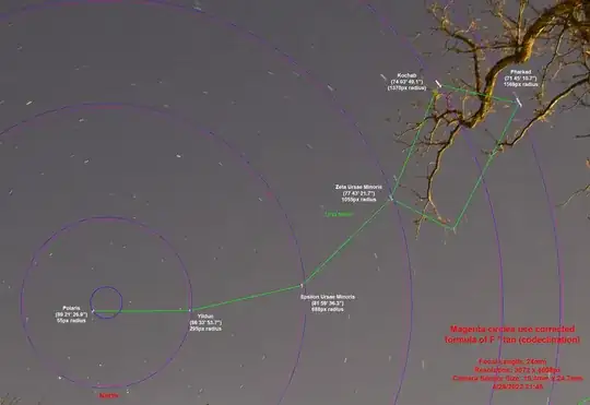

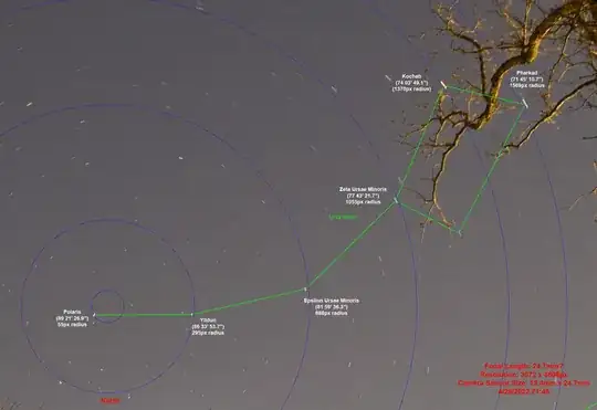

Here are some example annotated composite images. Note that the Polaris picture was taken with a different focal length from the others, so its pixels cannot be directly compared.
Polaris Star Trail
Cassiopeia Star Trail
Eltanin Star Trail
Aludra Star Trail

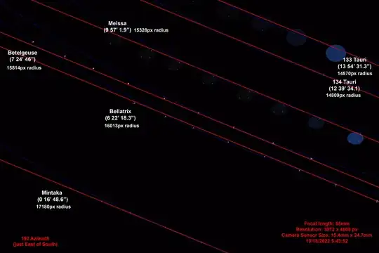

Empirically, I've observed that the paths of stars where Abs(Star Declination) >= 12 degrees seem to match these estimated radii quite well, usually within a couple pixels. However, this seems to break down near the celestial equator. Intuitively, this makes sense to me, because a star path on the celestial equator would follow a great circle, which would appear to an observer as a straight line. Indeed, the star trail of Mintaka, for example, which is within a half degree of the celestial equator, is very nearly straight, diverging from my estimated pixel circle radius quite obviously.
Here is a comparison of the star trail circles I estimated in blue vs. straight paths in red. It can be seen that Mintaka clearly follows the straight path more closely than the circle path. However, by about 133 Tauri, the star is back on track with the blue circle.
Mintaka Star Trail

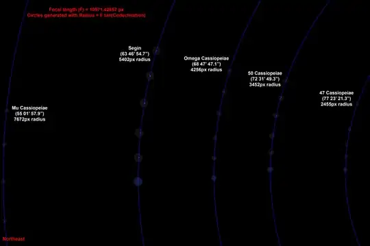

This brings the specific case of an Segin (Declination 63.78186111) taken with 55mm focal length to the following:
$$x = \frac{55\text{mm} \cdot 3072\text{px}}{15.4\text{mm}} \tan(90 - 63.78186111)~= 5402\text{px}$$
Here, $x$ can be used as the pixel radius of a circle to overlay on the star trail.

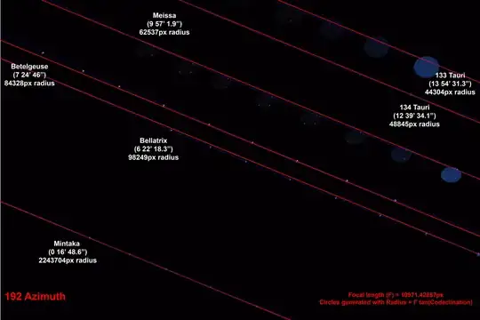

This applied quite nicely even down to Mintaka, which is very nearly at the celestial equator:
