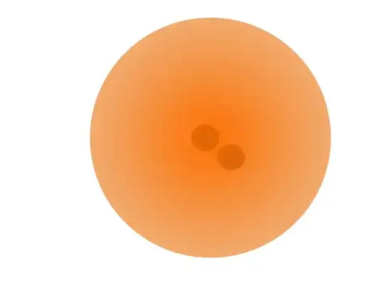

But the GMC is not homogeneous; it will have regions that are quite a lot denser, and quite a lot less dense, than the average. According to point #2 above, if some region is, say, 10× more dense than its surroundings, the ionized bubble will propagate $10^{-2/3} \sim 1/5$ as far in this region. The overdensity will therefore shield the part of the cloud that is behind it from the UV radiation of the stellar cluster. This effect causes "pillars" of neutral gas to appear behind the dense regions.
In the animation below I attempt to show the evolution of the Strömgren sphere. Stars are formed first in the center, but a secondary high-density region (which perhaps is too hot to start forming its own stars) shields the gas behind it, shaping a pillar.
pillars
