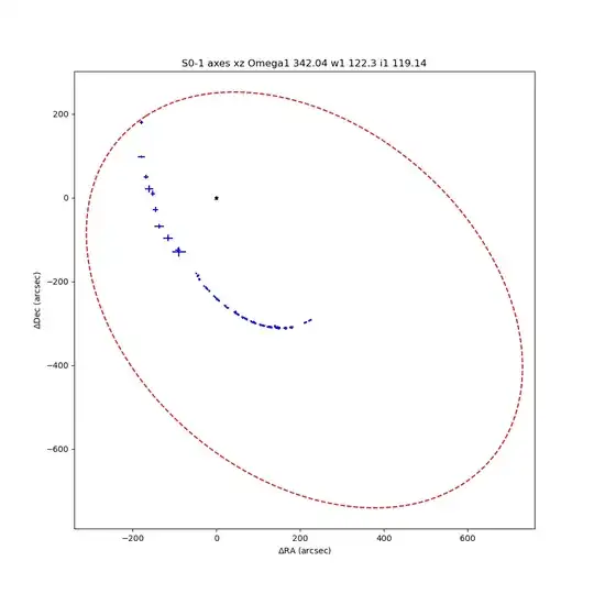

I am helping my high schooler with a research paper that uses PyAstronomy to fit the orbit of stars around Sag A. It isn't working because the angles (parameters Omega, omega, and i) seem to have a different reference point. It does work for Star 2, but when we try to do the same thing for Star 1, the initial inputs from the paper fit terribly.
Here are the initial inputs:
i = 119.14 degrees
Omega = 342.04 degrees
omega (w) = 122.3 degrees
a = 595 mas
e = 0.556
tau = 2001.8 years
per = 166 years
She is trying to replicate the results of this paper: An Update on Monitoring Stellar Orbits in the Galactic Center
One difference between the paper and my teen's program is that she is using Python and PyAstronomy, and they used Mathematica. PyAstronomy creates a KeplerEllipseModel object and specifies the axes as xz.
This is the output graph. The blue are the observations and the red is the ellipse created using the values from the paper.
Star 1 orbiting Sag A
We did a grid search to look at varying the 3 degree parameters (Omega, omega, i), but didn't come close. We also looked at the graphs using the other two axes (xy and yz), also no joy. Does anyone have any ideas on how we can improve this initial fit? The end goal is to run MCMC to sample a^3 against t^2. I hope this makes sense, I am a programmer.
