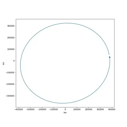

From inspecting the JPL ephemeris website, the ephemeris with the longest time span as of this writing is DE441, which spans from August 15th, -13200 to March 15th, 17191. It is less accurate than DE440 (which covers the time span 1550-2650 AD), but is more stable over long time periods. For reference, between the years 1970-2020 the difference between DE441 and DE440 is less than 2 meters.
You can access this ephemeris using astropy. For example, I prepared the following script from astropy's tutorial, evaluating the Moon's position for Julian year -3000. The script will take a while to run the first time (since it needs to download the ephemeris), but subsequent runs will be much faster.
import numpy as np
import astropy.units as u
import astropy.time
import astropy.coordinates
import astropy.visualization
astropy.visualization.quantity_support() astropy.coordinates.solar_system_ephemeris.set('de441_part-1')
time_stop = astropy.time.Time('-3000', format='jyear') time_start = time_stop - 27 * u.day time = np.linspace(time_start, time_stop, num=1000)
location = astropy.coordinates.EarthLocation.from_geocentric(0 * u.m, 0 * u.m, 0 * u.m)
coords = astropy.coordinates.get_moon(time, location).cartesian
plt.figure(figsize=(9, 9)) plt.gca().set_aspect('equal') plt.plot(coords.x, coords.y) plt.scatter(coords[~0].x, coords[~0].y) plt.savefig('moon.png')
Moon orbit for the year -3000
