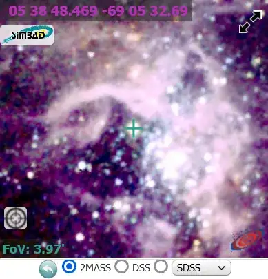

On the right of the SIMBAD page, if you select the '2MASS' radio button, the Aladin Lite image resembles a lower-resolution subset of the JWST image rotated clockwise a little.
2MASS/Aladin Lite image of region in question
