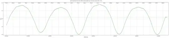

Here's a daily plot (at midnight) of the light travel time from the JWST to the centre of the Earth, courtesy of JPL Horizons, using a script derived from the one in this answer. There are more graphics & scripts related to the JWST here. Times are in TDB.
Light travel time from JWST to Earth, 2022-2024
The light travel time to a location on the Earth's surface has a small extra variation due to the Earth's rotation. And of course, you can't get a direct line of sight signal from the JWST when you're on the wrong side of the Earth. ;)

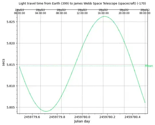

Here's an hourly plot for today of the distance from the JWST to its control centre, the Space Telescope Science Institute, which is located on the Johns Hopkins University campus. I used longitude -76.622987, latitude 39.332887, altitude 0.073 km as the coordinates.
Light travel time, JWST to StSci, 2022-Jul-19
Here's my plotting script, running on the SageMathCell server.
