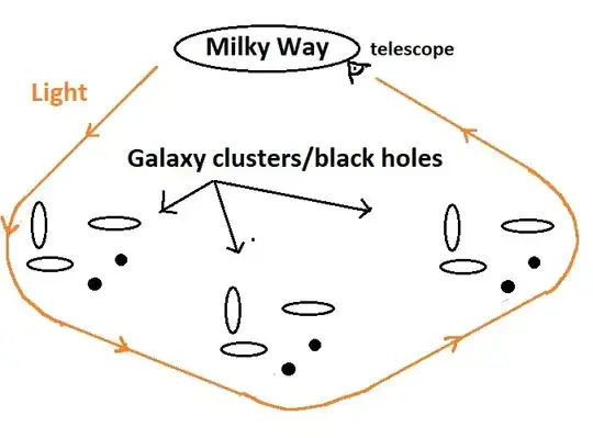

As I am watching the beautiful deep field picture of the James Webb Space Telescope. I noticed the gravitational lensing. So I asked myself whether it is possible somehow a successive cluster of galaxies or black holes forming a mirror instead of a lens. Which means making light coming from our galaxy doing a U-turn. This way we can maybe observe our galaxy in the past.
Is it possible somehow that one of the galaxies in such pictures is actually the image of the Milky Way:

    And possibly several different ages and versions !?!?! :) An interesting question. Also, not just about gravitational lensing, but about weird geometry of the large-scale universe? Like mirrors in a fitting room at a clothing store? :) – paul garrett Jul 14 '22 at 03:25
In theory, it's possible, but in practice it's extremely unlikely. The deflection angle is small unless the light ray passes very close to the centre of mass of a compact lensing body.

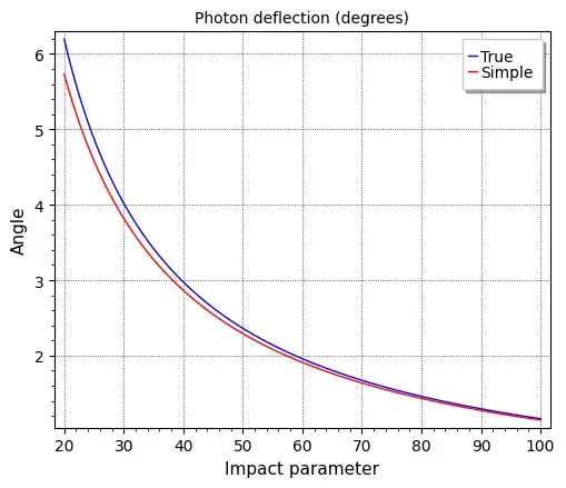

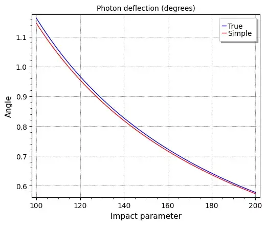

Here are a few graphs of $\theta$ vs $b$. The True value was computed using a high-precision evaluation of an elliptic integral, the Simple value uses the equation given above.
deflection 100 - 200 As you can see, the simple approximation is still reasonably good in this range.
deflection 20 - 100
The simple approximation is starting to fall behind.
