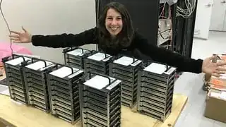

That means you can record the data digitally and sent it home later, just like how each dish of the Event Horizon Telescope recorded their digitized streams to hard drive and then put those drives on an airplane bound for a central location where interferometry could be done offline months or years later.
