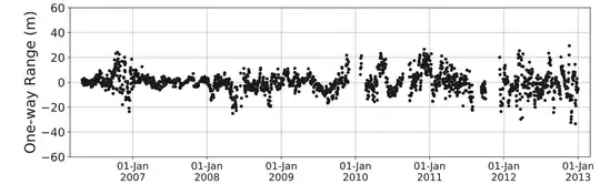

Venus:
Figure 6. Residuals of the Venus Express range data against DE440. The rms residual of the Venus Express ranges is about 8 m.

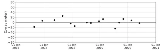

Jupiter:
Figure 9. Residuals of the Juno range data against DE440. The rms residual of the Juno ranges is about 13 m.
