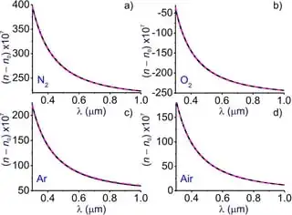

From The generalized Sellmeier equation for air (also here):
Fig. 5 The refractive index calculated as a function of the wavelength... http://dx.doi.org/10.1038/srep46111
Fig. 5 The refractive index calculated as a function of the wavelength using (blue solid line) the standard Sellmeier equation for N2 (a), O2 (b), Ar (c), and [Eq. (2)] for air (d) and (pink dashed line) Eq. (5) including only the terms with r = 12, 13, 14, 15 with parameters as specified in Table 1 for (a) N N2 = 2.688 @BULLET 10 19 cm −3 , (b) N O2 = 2.504 @BULLET 10 19 cm −3 , (c) N Ar = 2.879 @BULLET 10 19 cm −3 , and (d) the standard gas content of atmospheric air with parameters as specified in Fig. 1.
Fig. 1 The refractive index (a-d) and the group-velocity dispersion (e-h) calculated as functions of the wavelength using the full model of air refractivity based on Eq. (1) including the HITRAN-database manifold of atomic and molecular transitions (blue line) and Eq. (5) including M = 15 terms with parameters as specified in Table 1 (pink line): (a,e) visible and near-IR, (b,f) near-IR, (c,g) mid-IR, and (d,h) mid-IR and LWIR ranges. Absorption spectrum of air is shown by grey shading. Atmospheric air is modeled as a mixture of molecular and atomic gases with densities N N2 = 1.987 • 10 19 cm −3 , N O2 = 5.3291 • 10 18 cm −3 , N Ar = 2.3763 • 10 17 cm −3 , N H2O = 7.0733 • 10 16 cm −3 (10% humidity), and N CO2 = 9.4136 • 10 15 cm −3. The temperature is 296 K, n0 = 1.000273.

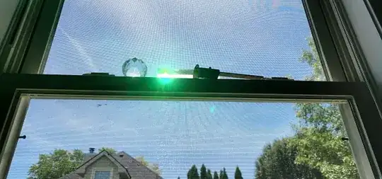

This is more a hypothesis rather than a definitive answer. Below is a photo of a prism with the camera in the path of the separated colors. Only a small part of the spectrum actually falls on the lens. The lens in this case was about a quarter of an inch wide, while the full spectrum was about 1 foot wide, so all we see here is blueish green. This prism was able to spread the spectrum over a foot in just a short distance, when a star gets refracted through the atmosphere, the refraction starts at least a hundred miles away, so your eye/telescope is only going to pick up very small fraction of the spectrum.
This can't be a full explanation though, as the video shows multiple colors in the same image. I have a few wild guesses, from attributing them to the telescope/camera lens, to multiple paths of refraction through the atmosphere.
