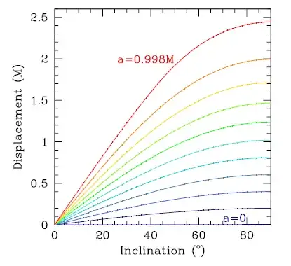

The photon ring around a non-spinning Schwarzschild black hole is perfectly circular and centered on the black hole.
The photon ring around a spinning Kerr black hole is almost circular (except for very high spins) but is displaced from the centre of the black hole (e.g. see Takahashi 2005; Johanssen 2015). The amount of displacement is related to the spin and the inclination of the black hole spin to the line of sight (if the rotation axis points towards you with $i=0$, then the ring is undisplaced). The plot below (from Johanssen 2015) shows a calculation of the displacement (in units of $M$, where the Schwarzschild radius is $2M$) as a function of inclination for values of the spin parameter ($GJ/cM$) varing from $a=0.0$ (no displacement) to 0.9 in steps of 0.1 and then 0.998.
Displacement of photon ring
