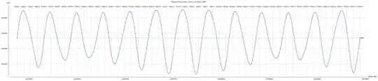

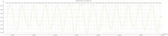

The mean Earth-Moon distance varies over the year, as I mentioned here. It's interesting to compare that distance with the distances to the Lagrange point. Here are the relevant graphs:
The mean distances are
Bodies | Distance (km) |
Earth-Moon | 384,975 |
Moon-L1 | 58,106 |
Earth-L1 | 326,869 |
All of those plots were created using the script in the linked answer. The Horizons ID for the Earth-Moon L1 point is 3011.
