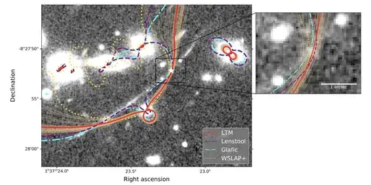

Figure 2 from the paper (which isn't yet available online, but I think it's ok to share here with proper credits) showing the caustics predicted from four different lens models:
earendel Credit: NASA, ESA, Brian Welch (JHU), Dan Coe (STScI).
The red curve that I used in the image you post is the "Light-Traces-Mass model" (LTM; Zitrin et al. 2015). To understand the effect of the uncertainties in the model, the posterior distribution was sampled and used to generate critical curves from each resultant parameter set. Those are the thin brown lines close to the red. In 80/100 of such model runs, Earendel is within 0.1 arcsec of the line, with a maximum of 0.4".
