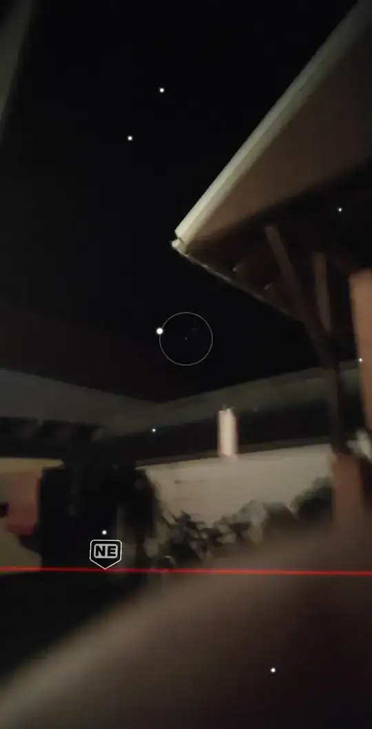

I am from Germany and at 11 PM I was outside and I saw a star, rapidly twinkling in blue, red and white. At first, I thought it was a plane, but it didn't move.
I took a picture of it, but you can only see a blue-ish dot on the photo.
I am from Germany and the star was in a north-east direction and it's currently around 12 at night.
Here is a photo I took of the star:
Picture of the star one
This one is for the direction of the star. It's in the circle you can see there, all of the large stars in the photo are from an app-generated an overlay.

    https://stellarium-web.org/ will help you find it – Aaron F Mar 28 '22 at 01:33
    What about the other white dots (there are at least five that can't be stars)? Interfering street lights (reflections in the optics)? – Peter Mortensen Mar 28 '22 at 19:42
  • What is your (approximate) location in Germany (the range in latitude is about 8° and 11° in longitude)? What is the field of view / (effective) focal length of the camera? – Peter Mortensen Mar 28 '22 at 19:46

The star is most likely Vega.
It doesn't actually twinkle, the technical term for this is "scintillation", and is purely an atmospheric effect.
The general idea is that stars are so far away, they are infinitesimally small points of light. So, even the slightest changes in atmospheric temperature or pressure will cause the atmosphere to refract the light differently. And the different wavelengths of light are affected less (or more), causing the colors to separate out (similar to a prism).
You'll notice this tends to happen more to stars that are closer to the horizon. This is simply because you're looking through more atmosphere, and there's a largely likelihood of a significant change in refraction. And also because you'll be looking over close objects like roofs or pavement which are exchanging heat with the atmosphere.
It tends to happen with brighter stars mostly because your eye isn't sensitive enough to pick up the changes on dimmer stars. Planets are also less effected, because they are not nearly point sources like stars are.
