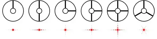

The diffraction pattern depends on the shape of the mirror, as well as on anything that is in front of the mirror, i.e. the secondary mirror and the arms holding it (called "struts" or "spider"). In general, an edge will result in spikes perpendicular to that edge. A round mirror, such as Hubble's, results in concentric rings, but its secondary mirror is mounted on a plus-shaped spider, and hence point sources observed with Hubble will have plus-shaped spikes, as seen below:
HSTpattern NGC 6397 globular cluster. Credit: NASA/ESA/H. Richer.

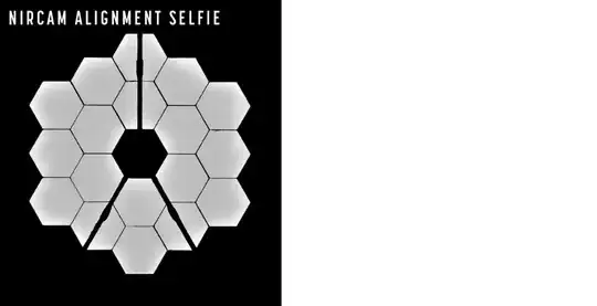

Additionally, Webb's secondary mirror is mounted on three arms. The two lower arms are actually aligned with the hexagonal pattern (on purpose, I presume), so the diffraction caused by those fall on top of four of the six spikes. But the upper boom is vertical in the images, and thus gives the fainter, horizontal spikes.
You can see the alignment here on this "selfie" (created using a specialized pupil imaging lens inside of the NIRCam instrument that was designed to take images of the primary mirror segments instead of images of space):
JWSTselfie Credit: NASA.
Below you see the resulting diffraction pattern from various spiders:
diffraction
