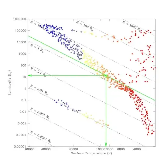

If we talk about Main Sequence stars, yes, you can constrain your fictional star by two parameters. The crucial parameters in the diagram, as you said, are the mass and the radius. This is why the HR diagram well represents the stellar population with two axis. Of course, for your scope, we need to do some assumptions. For example, the metallicity, that for your purposes can be fixed as the Solar one. Or, that the initial mass is already in a condition to contract.
You can see it this way: the luminosity is connected with the radius (because it depends on the irradiating surface), while the temperature is connected with the mass (the more is the mass, the more is the pressure at the center of the star).
If you have $L \sim RT$ and $L \sim M$, then you also have $RT \sim M$. The degeneracy from one parameter can be overcame if you have your reference star (the Sun), which allows you to trace isoradii lines on the HR diagram. See here for example: enter image description here Or, that is equivalent, you can express your first equation (Stefan-Boltzmann), in Solar units as well (as shown here).
Try it out just by your self: choose a mass, or observationally speaking, choose a luminosity. Then trace your line on the HR diagram, and find your star. That star has a defined temperature (spectral class), Mass and Radius as well.
If you need the exact equations, feel free to ask please.
