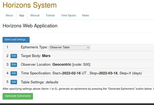

If you go to to JPL Horizons it will look something like this (you may get different defaults if you've been there before): Initial JPL Horizons screen

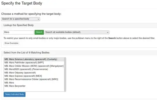

You need to change the 'Ephemeris Type' to 'Vector Table' and then select the 'Target Body' by hitting Edit. You can then type in a target; putting in Mars will result in a list of options asking you to clarify which "Mars" you meant: Entering Mars into the JPL Horizons Target Body selection box I'm assuming you want you want Mars (the planet) itself, rather than one of the spacecraft or the barycenter (slightly displaced from Mars's center due to Phobos and Deimos) so you should select 'MB: Mars'

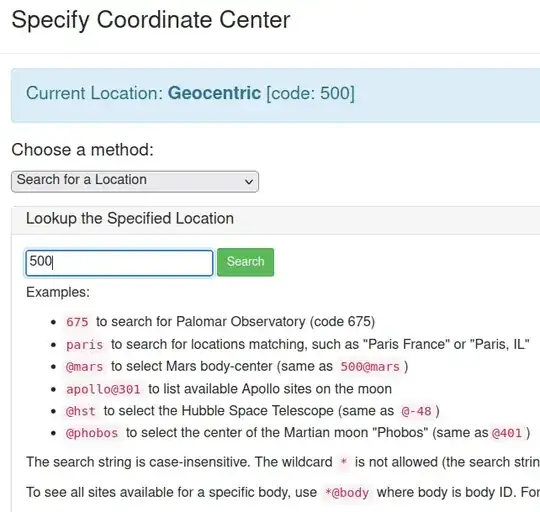

Next you need to select the coordinate center where you want the vectors and distances from - in your example this will be the geocenter which is code 500 in Horizons (@earth works as well but will popup a list asking whether you want the geocenter or the Earth-Moon Barycenter):
Selecting the coordinate center in JPL Horizons
You can then select the start and end times and the step size for the results that you want to cover. The default output is setup to provide a (somewhat) human readable HTML table with the full state vector ($x, y, z$ and velocities in $\dot{x}, \dot{y}, \dot{z}$), the light travel time, the range and the range rate. Since you are just interested in the range, I suggest you go into 'Table Settings' and select option 6. under output quantities to get the light time, range and range rate and set it to 'au and days'. For ease of later analysis, I would suggest you tick the CSV output as well so it looks like this:
Configuring the vector output in JPL Horizons

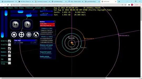

On this page, press Play [>] and all your questions will be answered. http://orbitsimulator.com/gravitySimulatorCloud/simulations/1645206515114_earth_mars.html It uses JPL Horizons as a starting point on 1/1/2022, and integrates into the future / past, telling you the distance & speed between Earth & Mars. For closest & furthest approach, look at Radial velocity. When it changes signs (which it does as it passes through 0 radial velocity), you are either at a max or a min. screenshot
